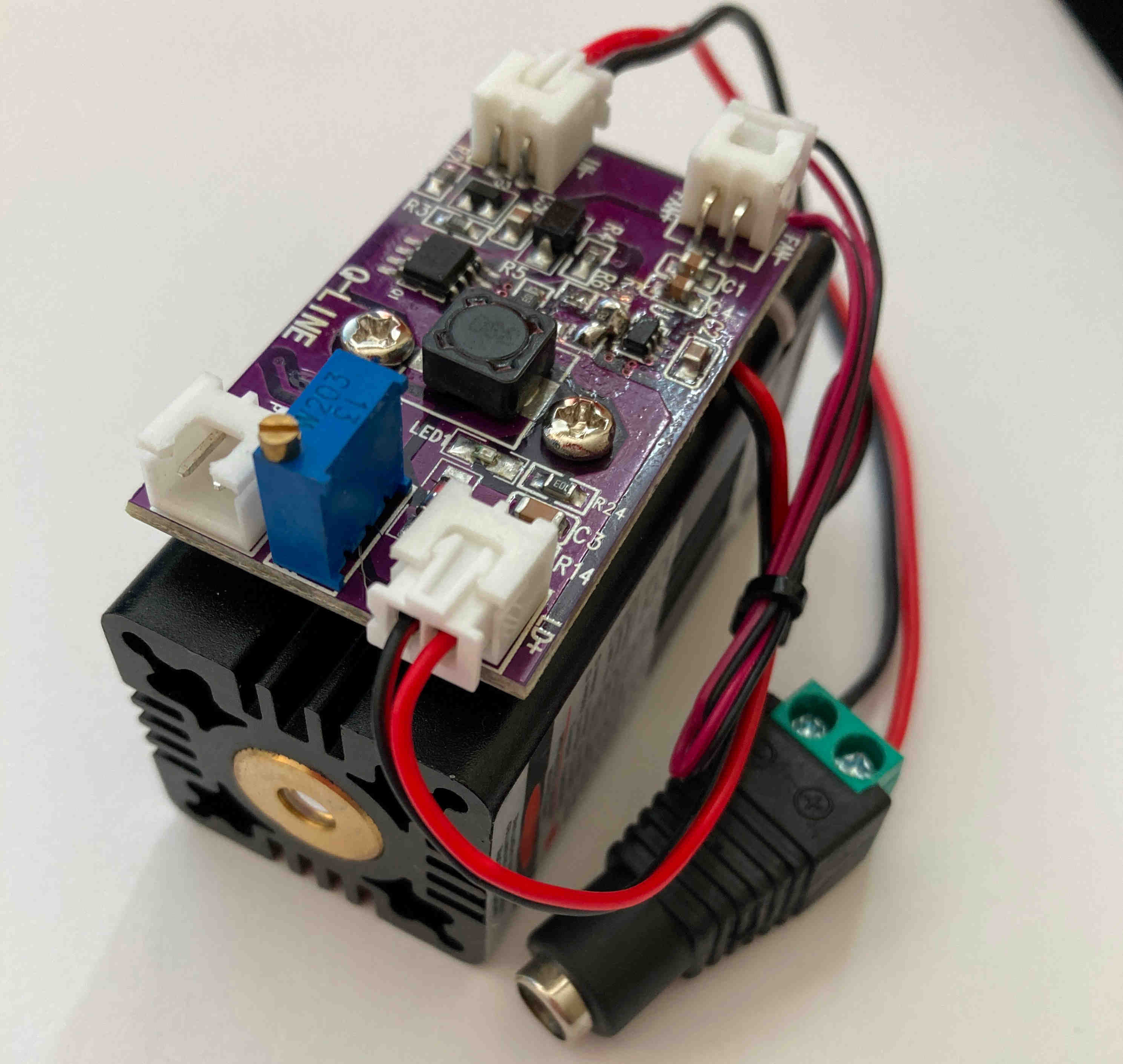

The listing says "12V Green Diode Lasers 532nm Laser Module Dot with TTL 0-30KHZ & Fan Cooling - Long Time Working"
* Wavelength: 532nm, Output power: 95-120 mW
* Operating voltage: DC 12V, Operating Current: <500mA
* Modulation frequency: TTL 0-30 KHZ
* Reverse polarity protection: Yes, with automatic identification of positive and negative
* Laser Module Size:74 x 30 x 30mm , Circuit Board size:71.5 x 35 x 20mm
The unit I received had the circuit board attached to the unit through a screw, but otherwise looks the same.
Controlling power
The reviews were helpful for example this one:
or you folks that are wondering about controlling this PWM, you don’t need a schematic. Look at the board Silk screen next to the Red and Green connectors on the fan power side. This unit is designed to handle two lasers, a Red one plugs into the Red connector that is next to the Green one the Laser power cable is plugged into. The two empty Red and Green connects ( next to fan connect) are the TTL inputs. Looking down on top of those two empty sockets, with the notch side away from you, the right pin on both of these is Ground. The other pin, on both has a pull-up resistor to turn both lasers full on, when NO TTL signal is there. When your TTL signal is present, the left pin of that connector will be pulled low or high to the 5V TTL signal, and if it’s low, laser turns off, if it’s high the laser will be on. The TTL will in effect be turning laser off and on, according to your TTL control
I tested with a signal generator (One titled "1HZ-500KHZ DDS Functional Signal Generator, Seesii DDS Function Low Frequency Signal Generator Sine/Triangle/Square/Sawtooth Waveform") and it seemed to work! I was a little confused about how the ttl works, it seem that the power of the signal is what controls it not the frequency at least in my testing. The laser board also has a little LED which shows the TTL signal and strobe to match the rate if you turn it low enough.

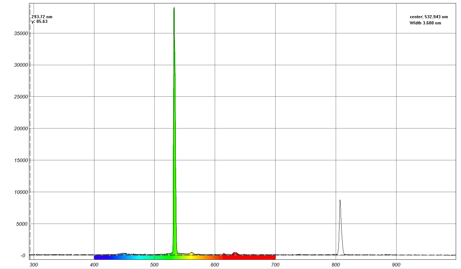

Frequency output
I got this result with an exposure time of 50ms.

I don't own a laser power meter, but I disconnected the fan and measured 1.5 - 1.6 watts of wall power. This translates to roughly 100-300mw of power depending on the efficiency of the laser. I wish I could be more precise then that, but that at least roughly matches the description

Some of the reviews mention this, and there are youtube videos on this topic but there are warnings that these very cheap lasers lack an IR filter. So it's important for safety to have laser safety goggles that block IR (800+ nm)
