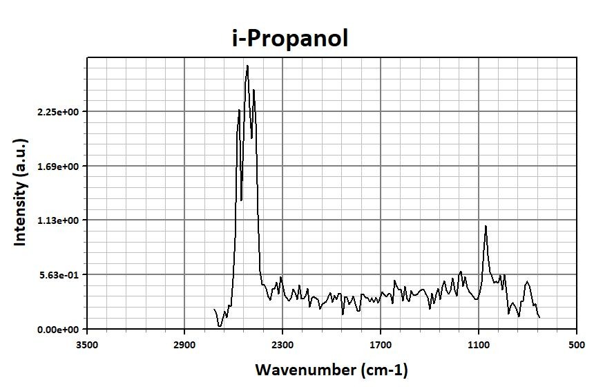

We tried to optimize the signal which went wrong and led to much more worse signal than before
Attached a image of the latest quality(of course, very bad) We did not calibrate software thoroughly which is cause of wrong scaling

Although it's a bit noisy we clearly identify isopropanol on your spectrum
What integration time did you use? With long exposures you should get a very clean curve like on the website. If not, it means alignment can be improved.
I recommend the 31S4M indeed

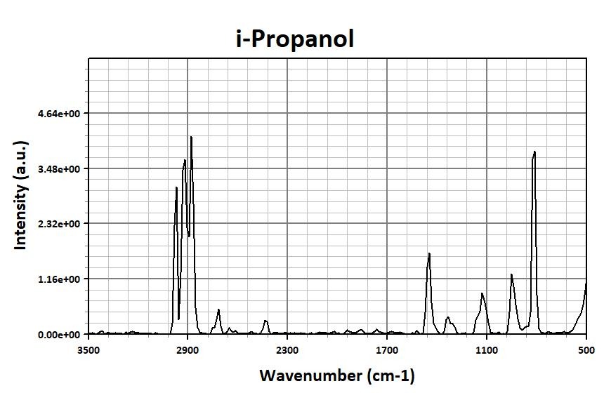

We ordered the 31S4M and waited until it arrived before we continued working on the spectrometer.
After setup the 31S4M we get much more better signals than 12A2M
Attached a image of i-propanol.
It seems we are on a good way now.

That's good to know!
On the occasion, I will make a post about cameras performances & how to quantify them but I don't have a lot of cameras to test (only 3). I made a setup for cameras evaluation in the past so I already know exactly how to do it
