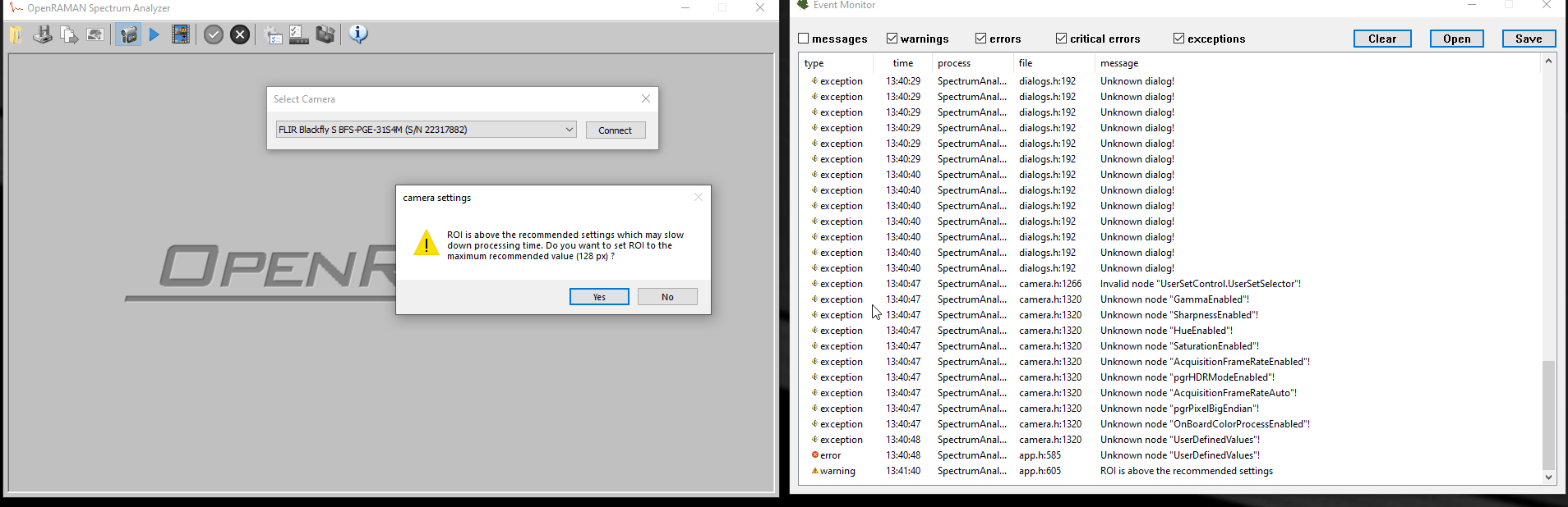

Thanks a LOT ! its working now, only complains about dead nodes and ROI above recommended settings ( see attached files with list of evemon silent nodes). Is there a workaround to save calibration parameters?

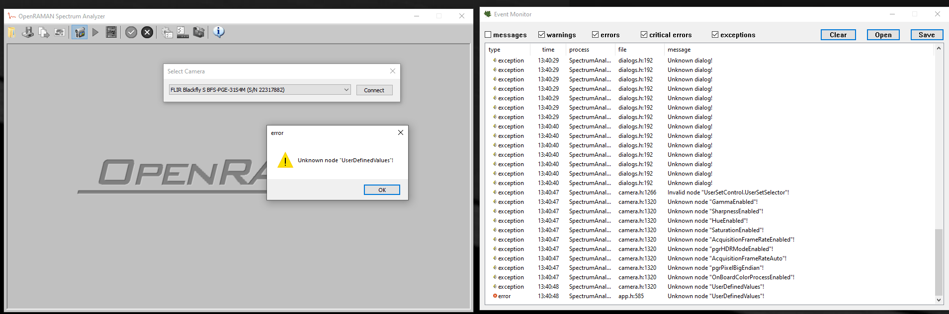

invalid node error during connect to camera in Spectrum Analyser

Not at the moment unfortunately. They also changed the way to access camera data and that's why you are getting the error with the UserDefinedValues thing.
I found an example in the SDK on how to write data to BFS cameras and I evaluate it's about ~1 day job. Problem is I have plenty of things that are currently more urgent and my brain has some difficulty with coding since my burnout.
If you can find a good programmer who is willing to contribute to the project (and who has access to the camera) I'll be happy to share pointers on how to update the code.
It's also worth to correct the other silent errors like pixel endianness but that you can also force in the spinview software directly.
