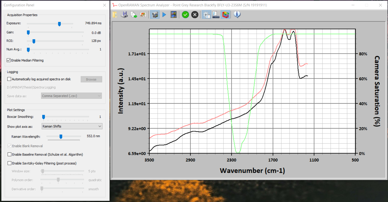

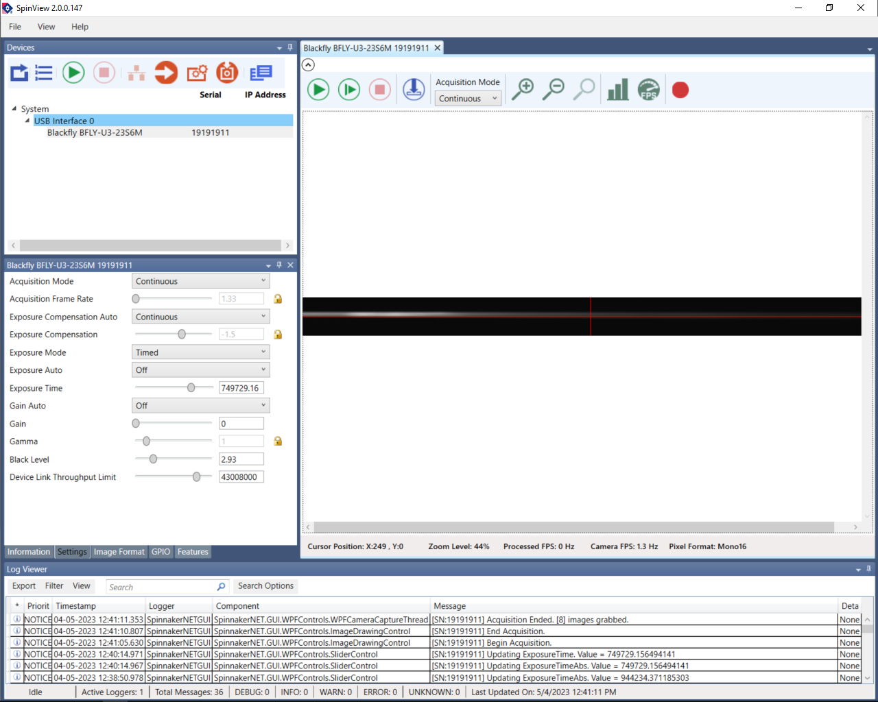

Here is a new measurement of acetone and the results on both Spinview and spectrum analyzer

It still looks a lot like fluorescence. The image is very clean in SpinView and your beam is well centered so optically speaking I don't see anything wrong.

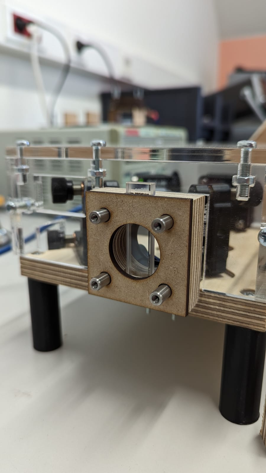

And could there be any problem with an open cuvet holder as shown below?

- CuvetHolder.jpg (96.48 KiB) Viewed 58009 times

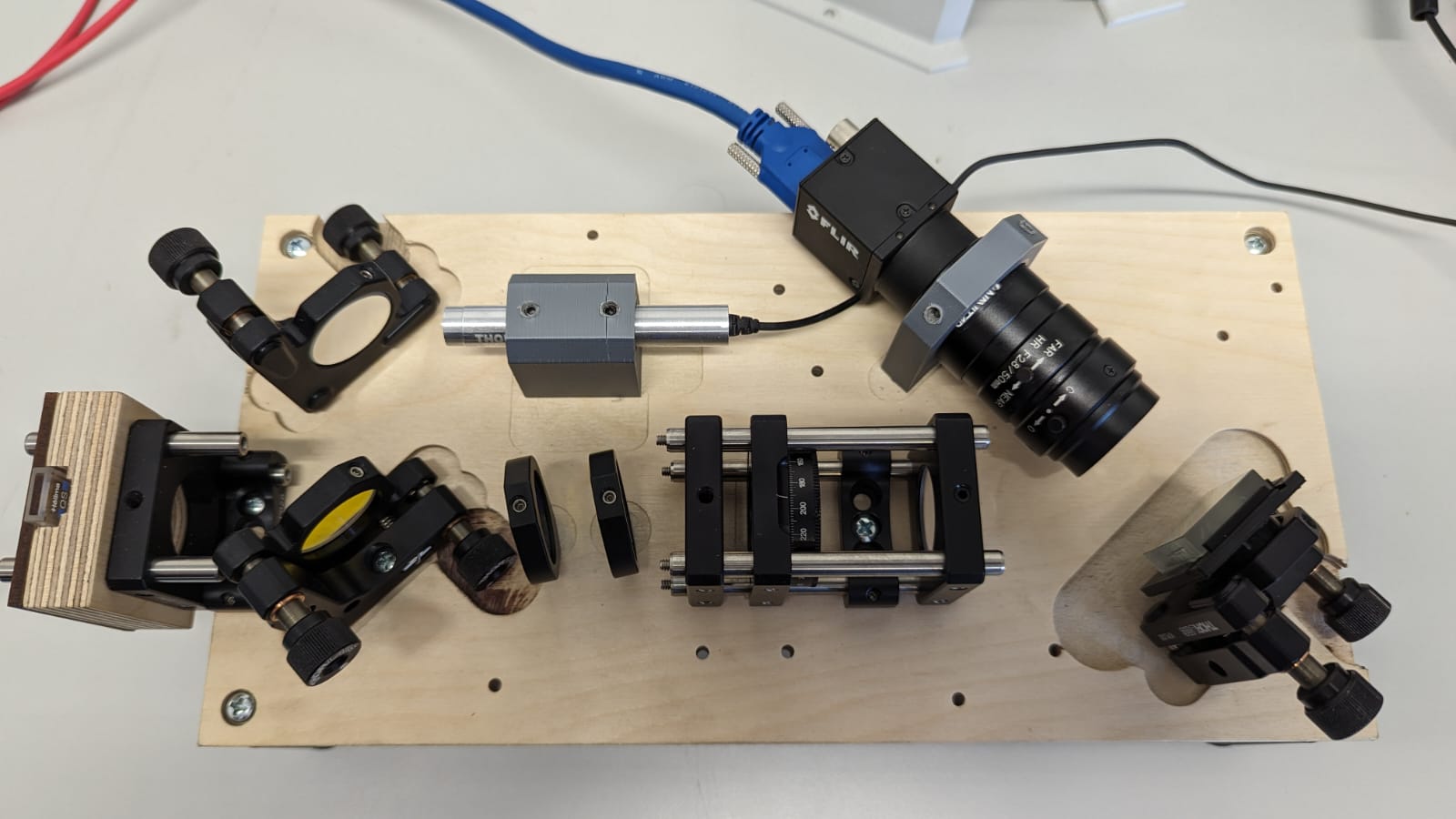

Could you take an image from above the setup? Also, could you confirm that you are using a lens to focus the beam?
What happened to me is that I contaminated my cuvette with a fluorescent compound and after that it was dead, impossible to remove the adsorbed contamination :-/ with the test tube when it happens I just replace the tube which cost only ~0.1€ or so.

The setup is as the instructions said, just the holder for the cuvet is different as I had a different cuvet. There is no light-covering enclosure around the cuvet. The source light is never reflected back towards the lenses, it just goes through the sample

Re: Calibration
On the picture I don't see any focusing lens in front of the sample. Could you confirm if I spotted right?
You'll need one or you won't get any signal for sure. I used a 19mm achromat but a microscopy objective can do the job as well.

Re: Calibration
I was not aware that another lens in front of the sample was needed. Could you point me to where this is mentioned?
Re: Calibration
They are in the cuvette assemblies themselves; the cuvette for test tubes even has a cylindrical lens to get a tighter spot size : https://www.thepulsar.be/article/raman-cuvette-upgrade/
The overall system is sketched here with a brief explanation: https://www.thepulsar.be/article/the-mo ... -openraman
