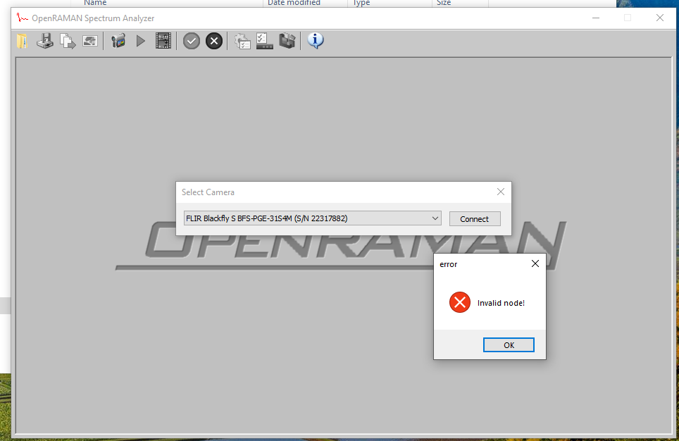

Have flir bfs-pge-31s4m camera which is recognised in Spinnacker
Spectrum analyser sees the camera but during connect have error 'Invalid node'
Also the same behaviour in successful fresh x64 Spectrum Analyser build in VS2022
Any help is appreciated
Regards
Oleg
invalid node error during connect to camera in Spectrum Analyser

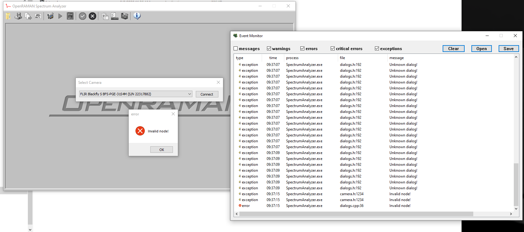

Could you run the program evemon.exe first, then launch spectrumanalyzer and try to reproduce the bug? It should give you a detailed log of everything happening.
From the name it looks like it's trying to access something that doesn't exist in the camera. I'll check in more depth when I'm in front of my computer today.
Re: invalid node error during connect to camera in Spectrum Analyser
Here is the screenshot with attached zipped err file
I confirm that it is coming from a portion of the code that should never trigger (fail safe). For some reason, one of the mandatory parameter of the camera (exposure, gain, ROI...) cannot be accessed.

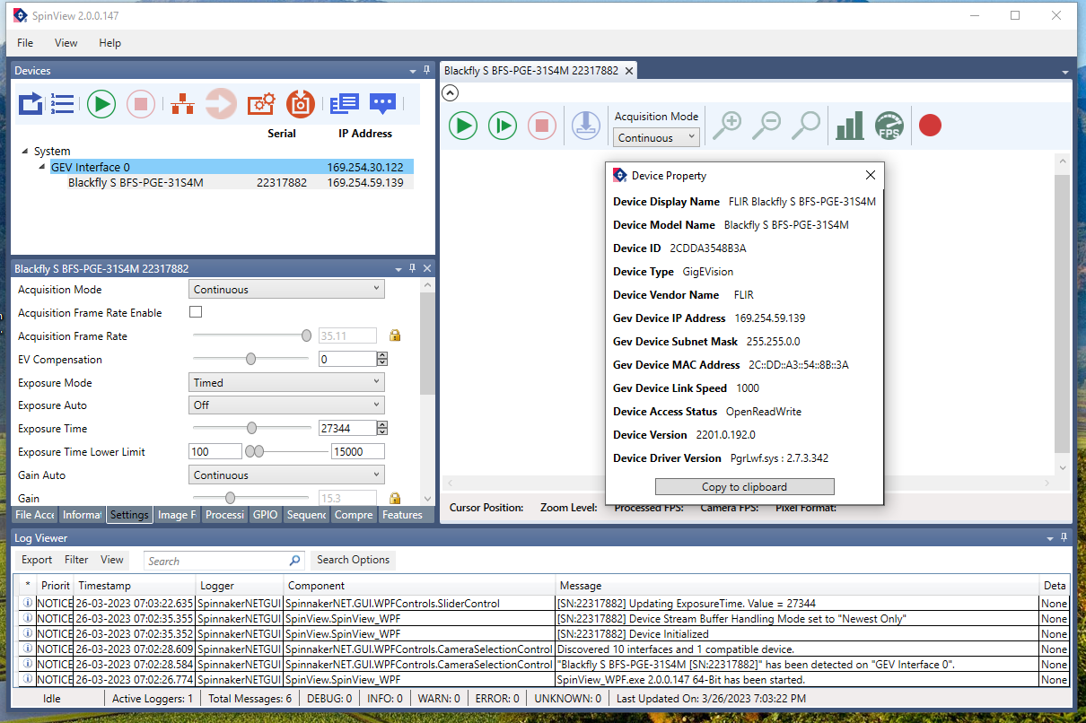

- Close all softwares (Spectrum Analyzer, SpinView etc.)
- Change your adapter IP to 192.168.100.1 with subnet mask 255.255.255.0
- Start SpinView and update camera IP; check that you can access camera frames (start acquisition)

Long story short, in the camera dll project you will find plenty of lines that initialize the nodes such as FloatProperty followed by strings like "Analog", "Gain". These are the addresses of the nodes inside the camera and should match the names in spinview.
The tricky part is that you should not be looking at the node label in SpinView ("AnalogGain") but click (right-click?) on it to display a full dialog with more information. There you will find the full node access path -- it's how I did it in the first place.
