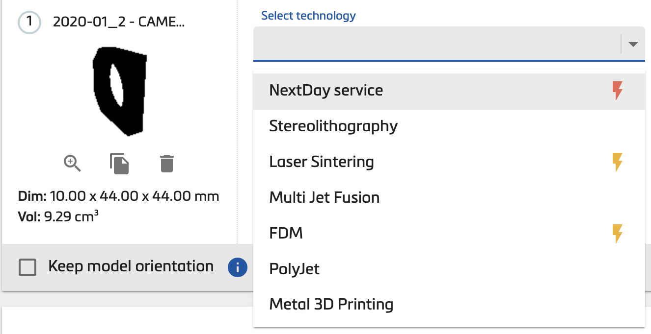

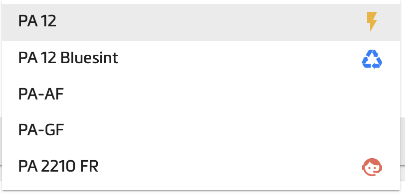

I am looking to 3-D print the parts for the performance edition OpenRAMAN via Materialise as noted on the bill of materials. I was wondering which options were chosen to print the specific parts?
The bill of materials mentions polyamide SLS, please could you confirm which options you chose and also for the polyamide FMJ pieces?

Laser sintering, sls stands for "Selective Laser Sintering "
FMJ -> Multi jet fusion
PA 12 should be fine to my knowledge
You might try dyed black for the finishing
Hope this helps
Re: Materialise 3-D Printed Parts
I confirm.
PS: did I write FMJ in the BOM or MJF? FMJ would be Full Metal Jacket, a typo :D

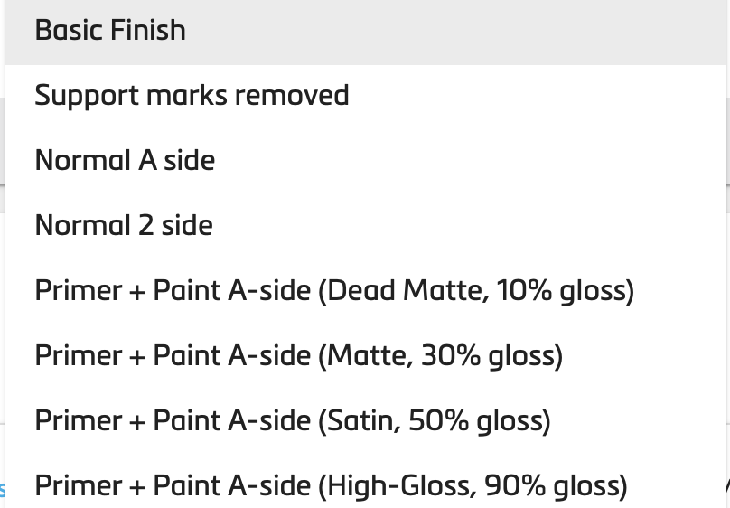

Thank you both, I assume for the following boxes, I do not need to tick them?
Screenshot 2023-04-21 at 10.19.12.png (9.54 KiB) Viewed 103120 times
Thanks for your help.

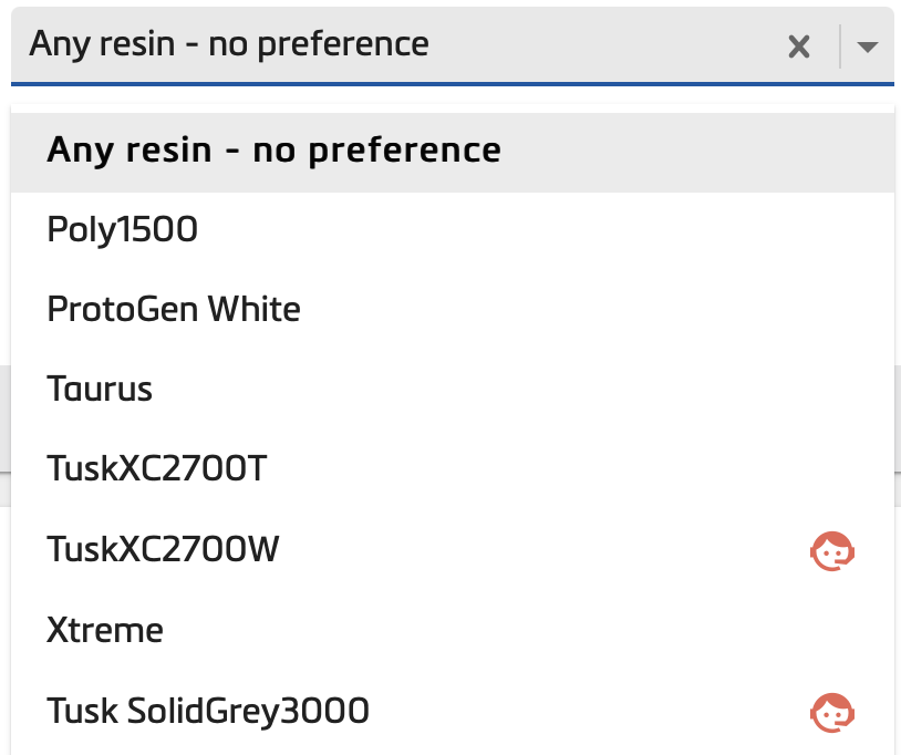

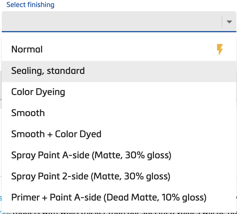

Thanks Luc, and what would you recommend for the resin and finish?
Screenshot 2023-04-25 at 10.03.09.png (59.71 KiB) Viewed 103106 times
Screenshot 2023-04-25 at 10.03.16.png (69.76 KiB) Viewed 103106 times
You can ask for the support marks to be removed
stereolitography is a bit like filament in that regards, you need posts/support for the print and they need to be removed after
