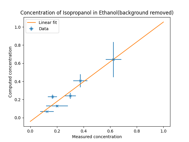

NaHBrO
Posts: 18
Joined: Tue Apr 11, 2023 12:52 pm
Re: Bright Isopropanol
Post by NaHBrO »
Alright I managed to redo the experiment. I used background removal to get to those results and wanted to share them here with you as a thanks for your help. I also fitted a linear function to it of the form y=a*x+b. The parameters a and b were compatible with their expected values (a=1 and b=0) within one standard deviation. The errors on the measured concentration were due to the resolution of my scale (about 200 mg) and the uncertainties on the computed values were calculated using the variance of the concentration parameter. I had to calculate the results slightly different than on the webpage in order to end up with one parameter alpha but it returned the same values for the computed concentration using the previous way. We now have our own idea on what experiment we would like to perform with our OpenRAMAN build. I will post the results and my progress here aswell since you guys strike me as the kind of people who would appreciate that.
Hope you have a great one.
