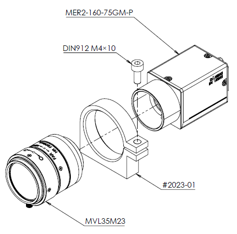

That's pretty much it. As mentioned, the weak point is (used to be) the camera bracket but I already redesigned it -- just not released yet.
With gentle driving and the spectrometer in a box with bubblewrap it shouldn't be an issue. For "production" grade stuff I would make a few changes:
  • only CNC aluminum parts, no 3D printed plastic at the exception of the cuvette thing
  • use ~3Nm torque settings for all M4 screws (metal/metal, not metal/glass)
  • replace the kinematic mount by either locking version or stainless steel "heavy duty" versions
  • replace the camera bracket by the new one
  • apply dots of epoxy glue on all non-torqueable parts (laser, camera c-mount etc.)
After that it should even survive DHL transport :)
FYI, this is the new camera bracket:
