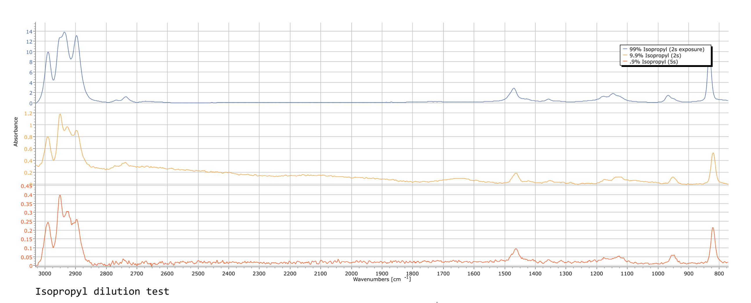

- Your results... what your spectra looked (for isopropyl alcohol which is what is posted on the website)
- Limit of detection if you have that

I used this 532nm fiber laser from civil laser which was only $1280 when I bought it (and when this is posted). I think it worked pretty well!
I measured to .9% Isopropyl but stopped there.

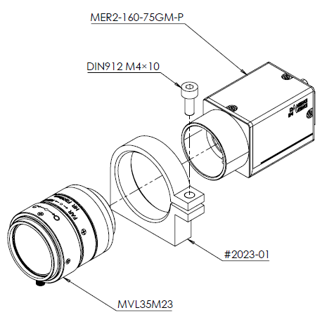

Interesting comment about the camera bracket. Did you check if the diameter (before drilling) matched the one in the drawing ?
I'm asking because recently I made a mod to use a NAVITAR 35 mm objective. The technical drawing mentioned something like 32.4 mm so I designed the part accordingly (it's a flange clamp) and when I got the parts (bracket & navitar lens) they did not fit! I was surprised to see that NAVITAR had changed their design and the objective was now 34.0 mm. I had to machine my bracket as well.
Changing parts are usually a nightmare in production environment (at least where I work). It would be good to find a way to keep ourselves "reactive" about that.

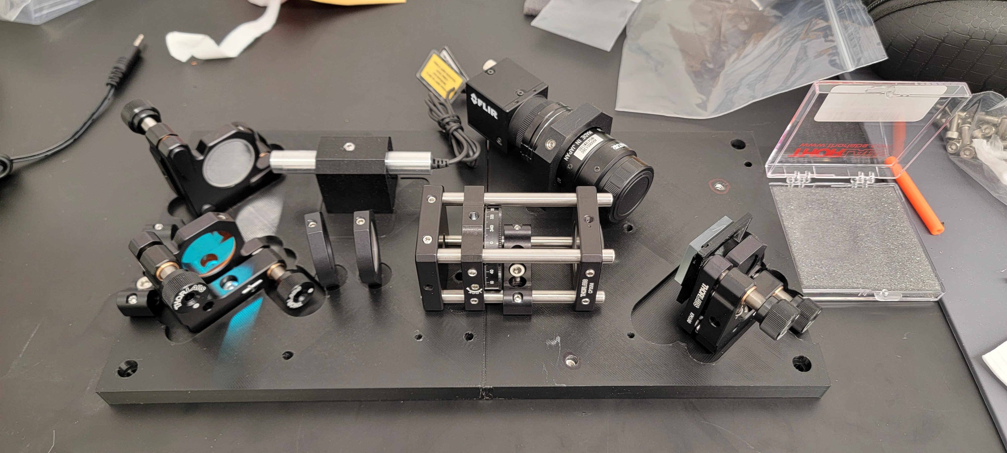

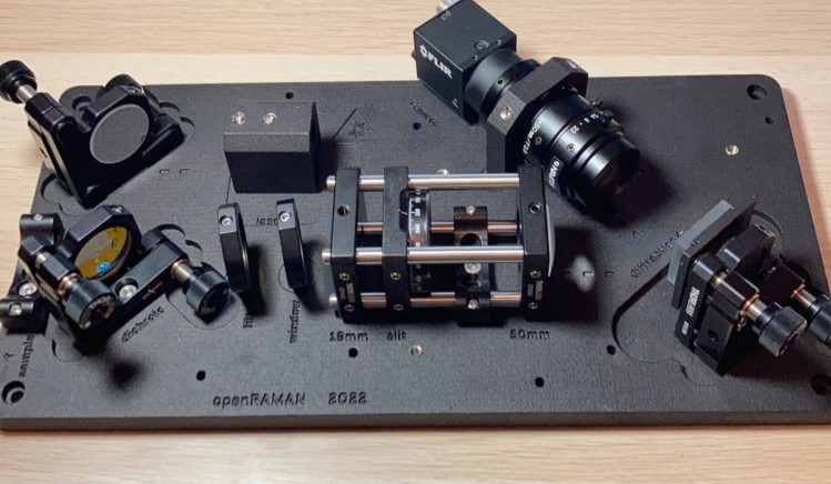

Finished my build of the starter edition!
I printed all of the 3D-printed parts myself on a Prusa MK3S+ printer with 0.4mm nozzle. The base plate, cover, laser mount, and camera mount are all PLA. The sample holder is PETG. I split the base plate into three parts and fit them together with tension pins. To minimize warping I printed the base plate parts tilted vertically on their sides rather than flat on their bottoms. All of the parts were printed with at least 50% infill and at the highest resolution setting.
I had the same issue with the inner diameter of the camera mount. Reprinted the part with diameter of 34.2mm. Not sure if that was the actual diameter of the printed part. Did not measure!
I found the alignment to be the most difficult step. It took me quite some time fiddling with the mirror and beam splitter to finally see the spectrum.
Overall a very fun build! It amazes me that I can build a working Raman spectrometer!

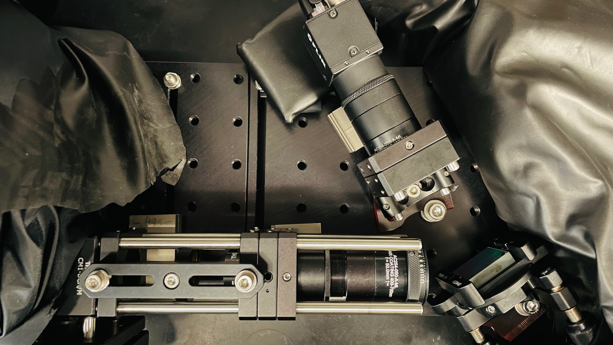

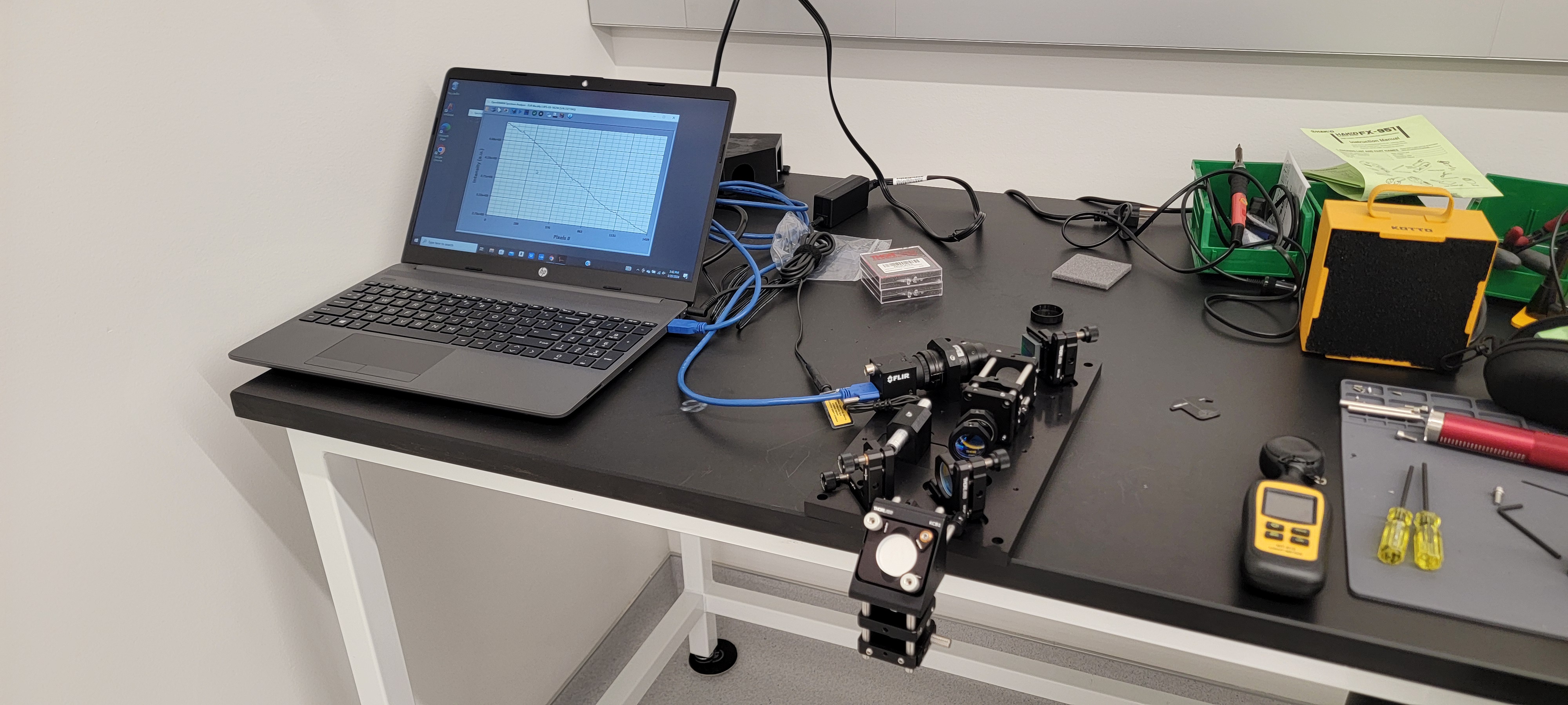

I built the breadboard version for my lab.
I had to make a few changes in order to have it work for my kind of samples. The significant modifications were:
1) Added a 40x objective in the pathway
2) Used a 3-Axes stage to hold and move the sample.
As with everyone, the alignment was the most time-consuming step. Using a Neon lamp helped a lot during the process.

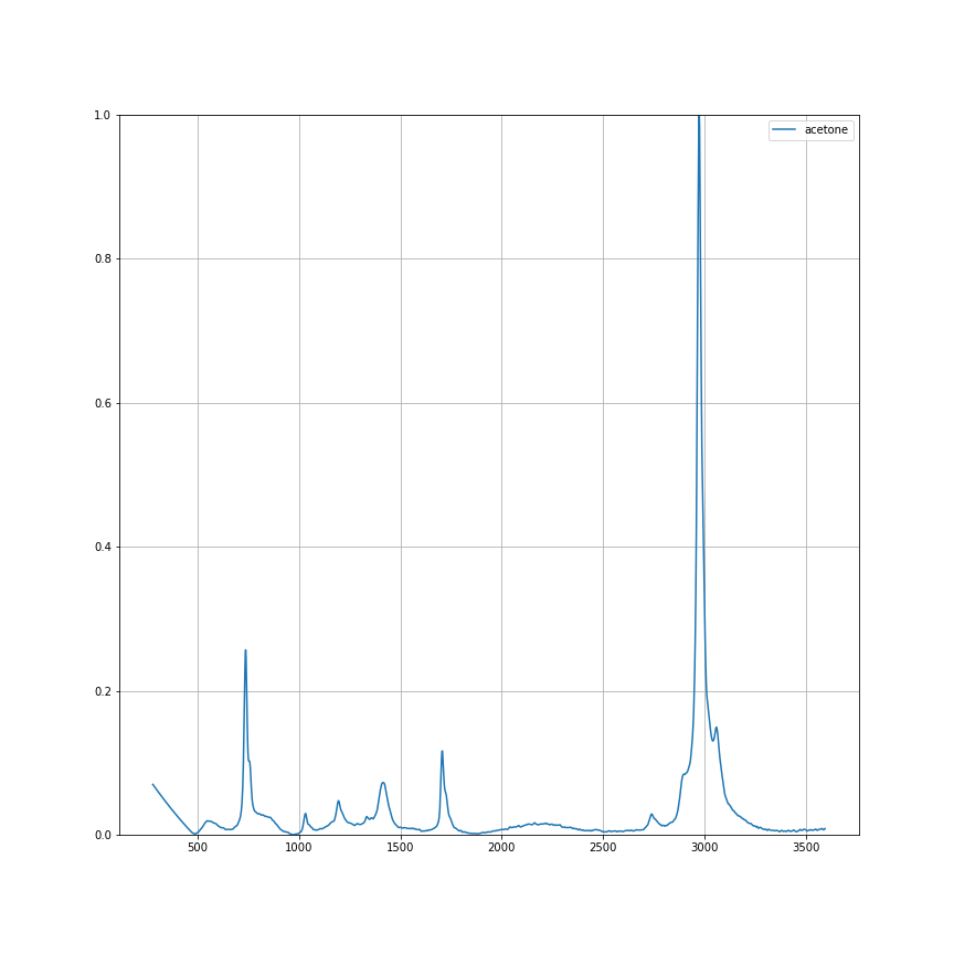

I attached the spectrum for acetone (sorry for not having it for IPA).

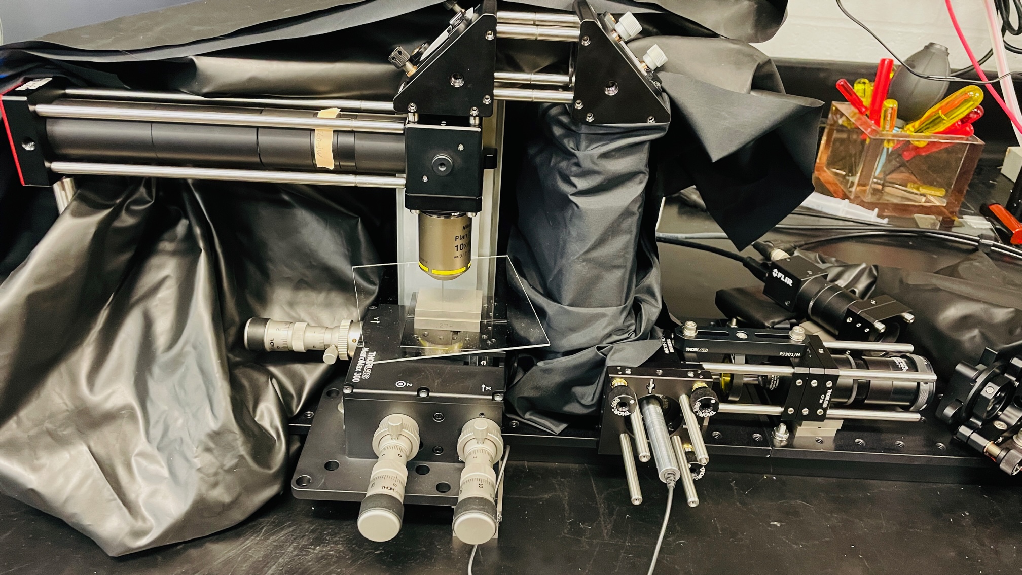

Built a breadboarded version of a performance version.
Example raman spectrum of acetone vs publicspectra's
Unfortunately scratched the LK1085L1-A plano-concave lens when inserting into the cuvette holder (printed with clear resin and coated with matte paint), will try rotating the slit and rest of the system afterwards to see if I can localize the issue or maybe ground the lens as it's the plano side that's scratched.
