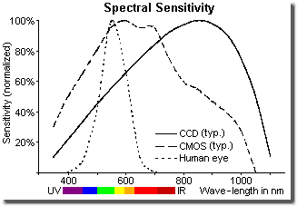

My suggestion (take with a grain of salt):
Here's what you would need:
A new laser (here's options from my supplier): https://www.civillaser.com/index.php?ma ... &cPath=705
3-5ish new lenses (the lenses have coating for 532nm so check if new ones are needed besides the "main ones": dichroic, fiber filter, longpass filter)
You would move the lens group around so the large doublet is now focusing the light to a fiber. You'd have to adjust for focus. You could use the spec to find the spot that maximizes the light received but it should be close to the effective focal length of the doublet. The small doublet would be unused.
A S1SMA plate that would receive the light
A new ccd spectrometer. You can hunt around on alibaba express for a used or cheap old one and make sure it's sensitive in the new output range.
3-Spectral-sensitivity-graph-of-CCD-sensor-CMOS-sensor-and-human-eye-3-Width-is-5mm.png
3-Spectral-sensitivity-graph-of-CCD-sensor-CMOS-sensor-and-human-eye-3-Width-is-5mm.png (4.05 KiB) Viewed 150000 times
