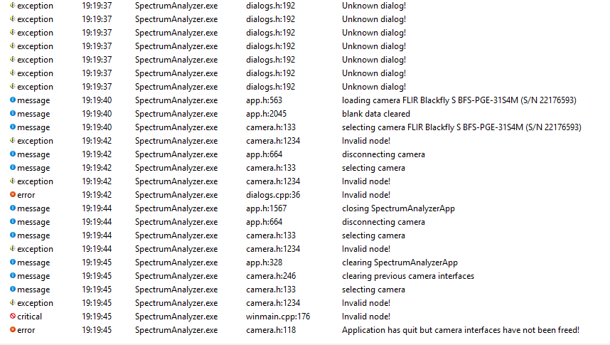

However I can't seem to get it to work in the openRaman app. When I click connect, it shows the camera, but if I try to connect, I get an "invalid node" error. I can't figure out where this is coming from. I don't have spinview running at the same time.
Here is the even monitor log.
Screenshot 2025-11-29 192009.png (59.12 KiB) Viewed 221654 times

I guess you are using the BFS and not the BFLY version of the camera ; the problem was already addressed here : viewtopic.php?t=15
there's a dll to download to fix the issue :)
