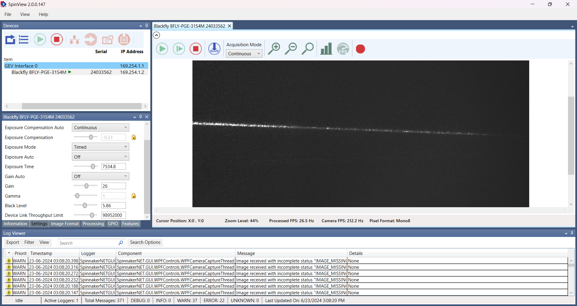

I am having trouble calibrating the Raman. For reference, I'm on step 9 (https://www.open-raman.org/build/starte ... /assembly/), and I'm not getting a similar quality of image as shown in the Youtube tutorial. This is the image I got:
Screenshot 2024-06-23 151105.png (777.49 KiB) Viewed 218096 times

The image you get looks like the spectrum you'd get from a coherent source (which seems to be the case since you're using a fiber locator on the photo). I'm just surprised by how broadband the spectrum is for such source. For step9 you should use a neon spectral lamp instead.
The quality of the image you observe is directly linked to speckle noise which arise from coherent source. If the fiber is a multimode one, you can try shaking the fiber rapidly. If the integration time is not too short you should observe a much cleaner image (averaging of many speckle grains). If the fiber is single mode (which is a possibility when I see the thickness of the line), you need to couple to a multimode first.

Quick question... is your slit horizontal instead of vertical by any chance? That would explain why it's so broad

I didn't check if the slit was horizontal or vertical - I was rotating it until I saw that the laser light passed through. It might be positioned horizontally, so do you know how I can get the laser light to pass through if I turn the slit to be vertical?
Lastly, when you say the image is broad, do you mean that the line is super long (not based on its thickness)?

What I'm surprised is the width of the light and the fact that you don't see it as you rotate the slit.

Yes indeed, but then I don't understand why you don't see the slit in the vertical position :-/

I presume you're simply imaging the slit out of the camera active area. Try rotating the grating when the slit is vertical. You should find the signal then.

It's always a multimode fiber (I don't own single mode ones). Just I don't have one with a large core so I compensate with a XY stage but it's an inferior solution. It's really a question of getting light on the slit and not 100um next to it.
Don't forget to rotate the grating, it's possible that you are at the edge of the available span. Design is 540-650 but it's very sensitive to the actual angle.
