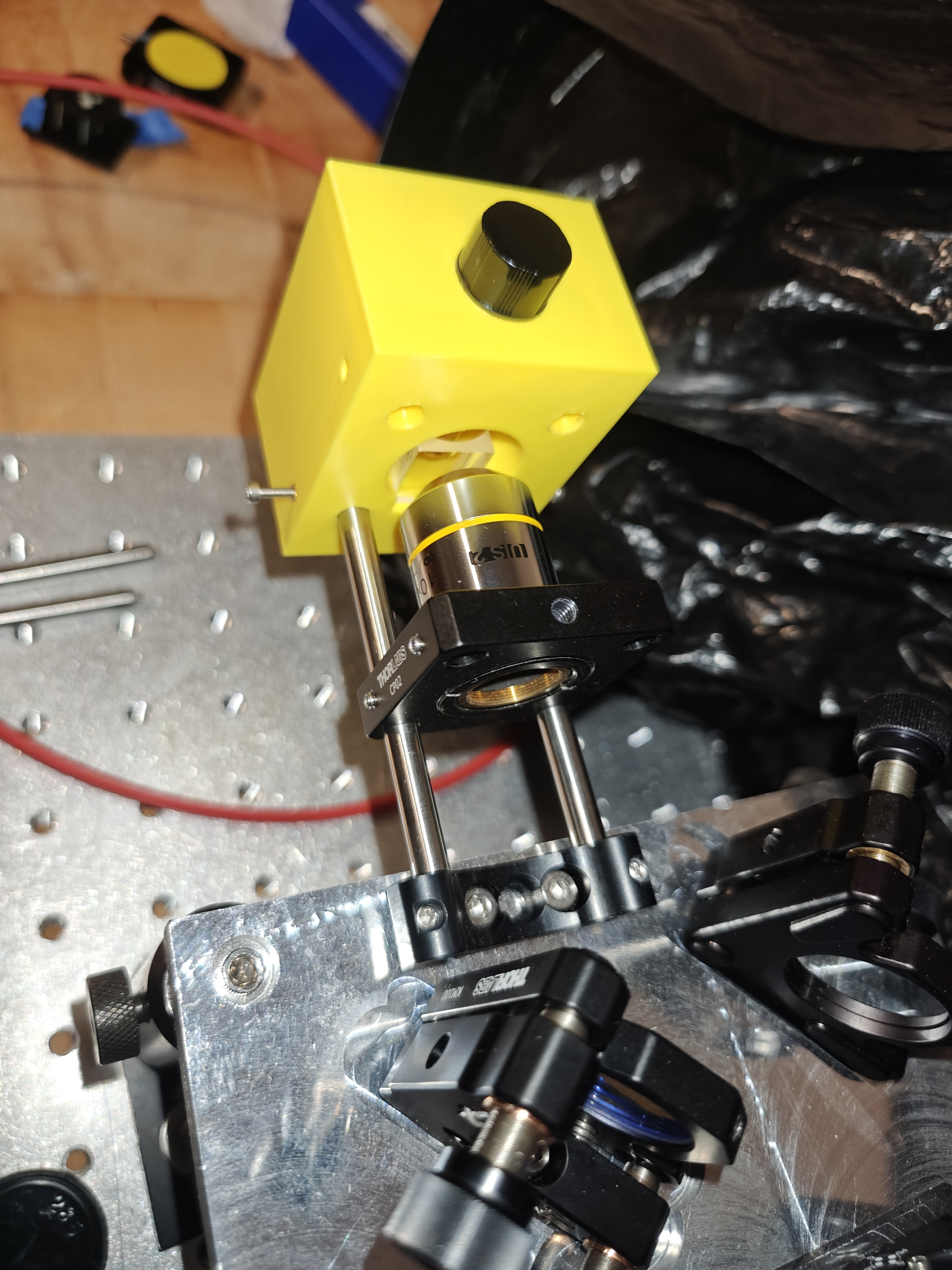

Firstly, I didn't have an achromatic doublet lens on hand and used a microscope objective 10x lens (https://www.edmundoptics.com/p/olympus- ... ive/29222/) instead, so I don't know if that's an issue.
I also used a different glass tube, so I redesigned the cuvette holder to what you see here:

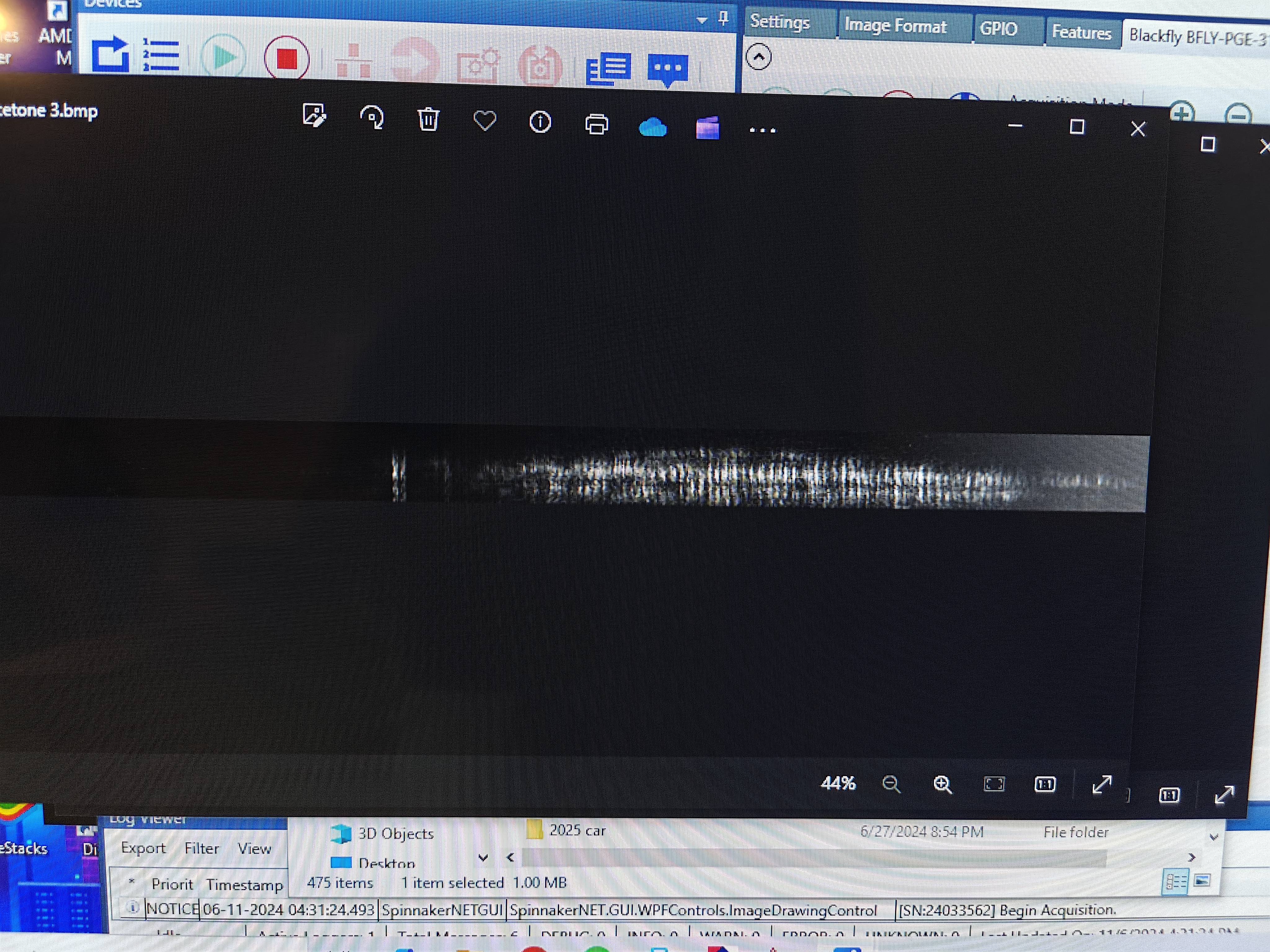

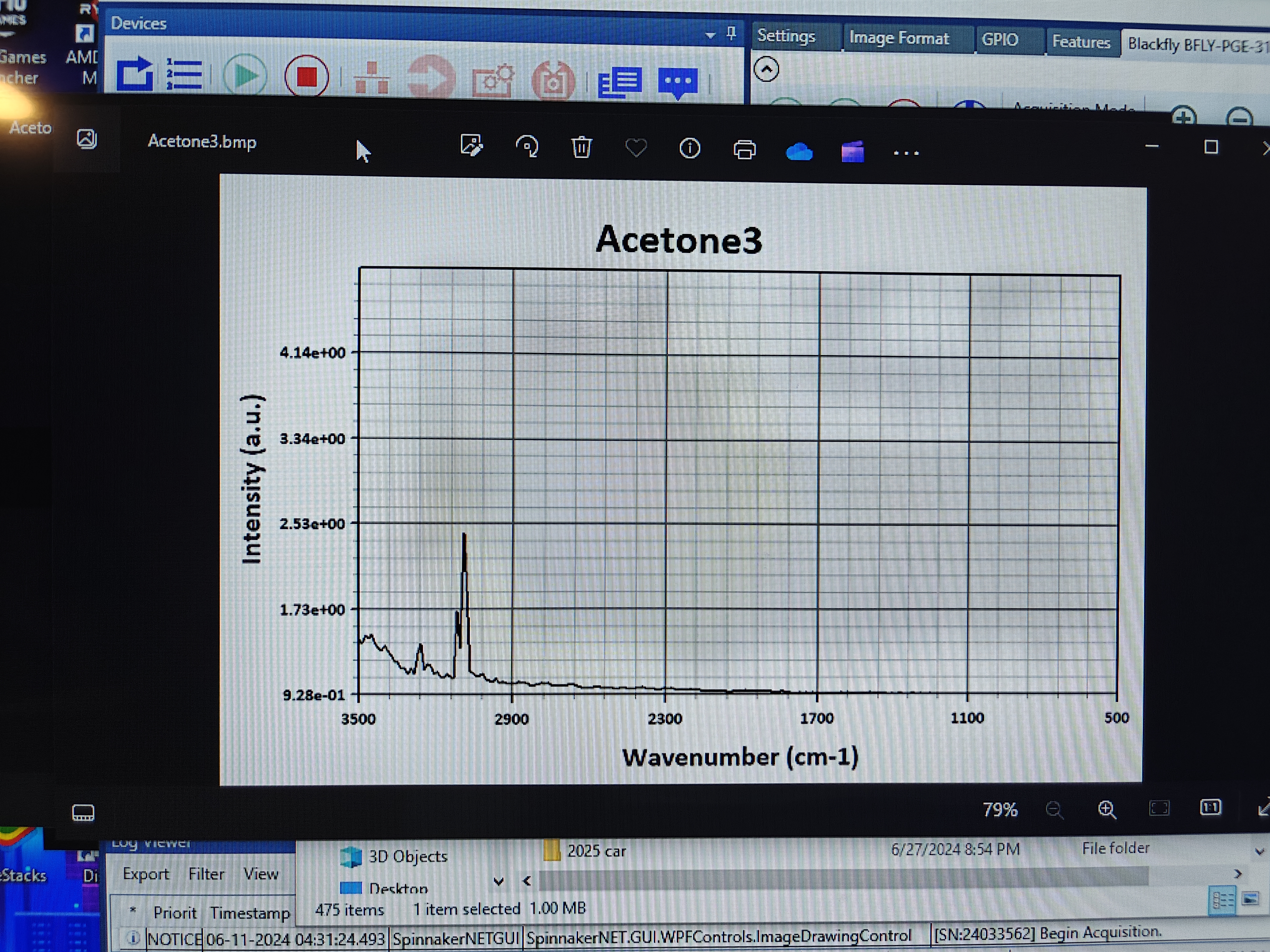

Note, this is the spectrum I got:
This is what I saw through the camera:

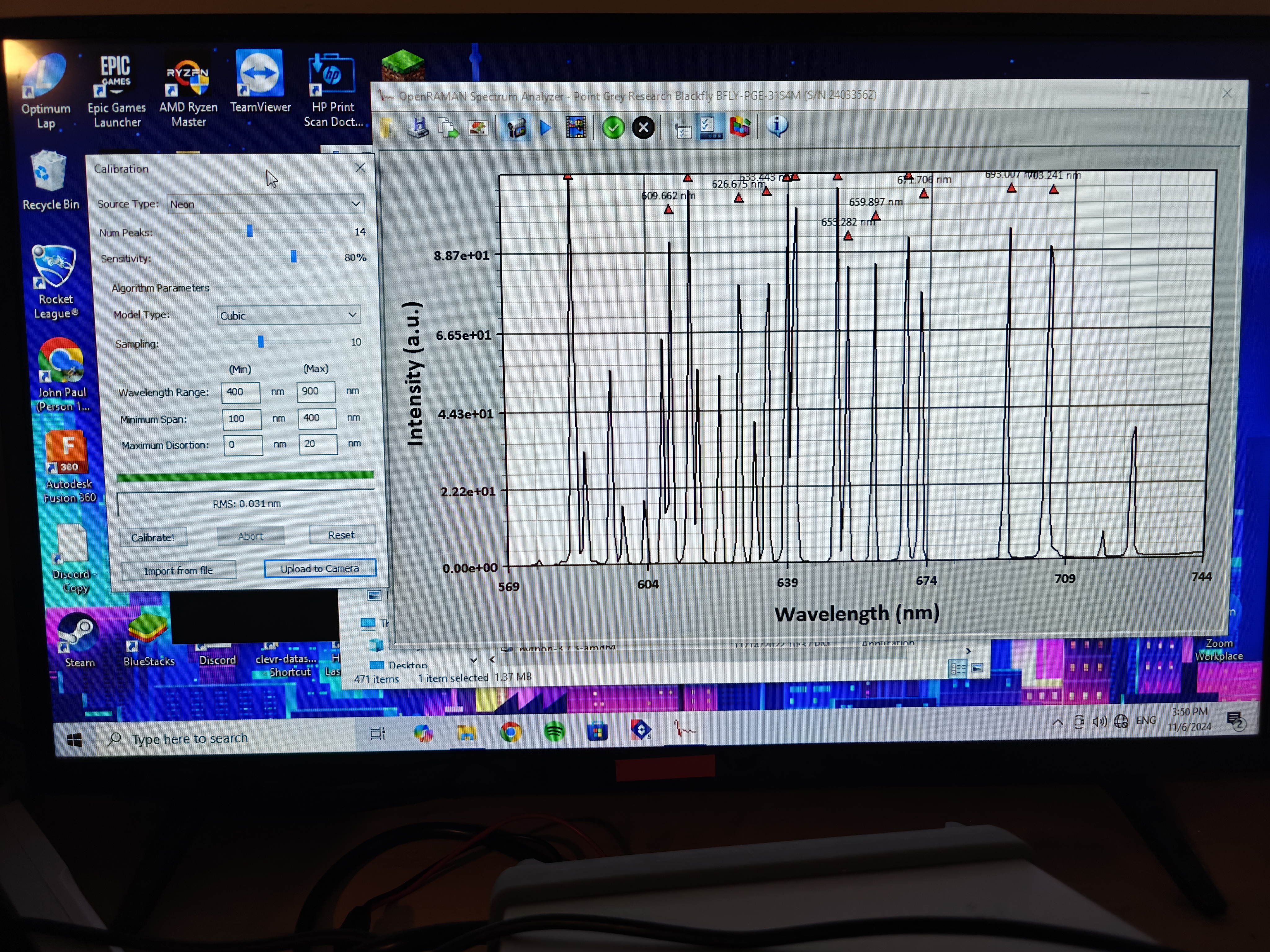

This is what I saw when finished calibrating the neon light
Re: Help With Acetone Spectrum Reading
The calibration looks fishy :-/ I'd say the spectrum needs to be moved to the right.
