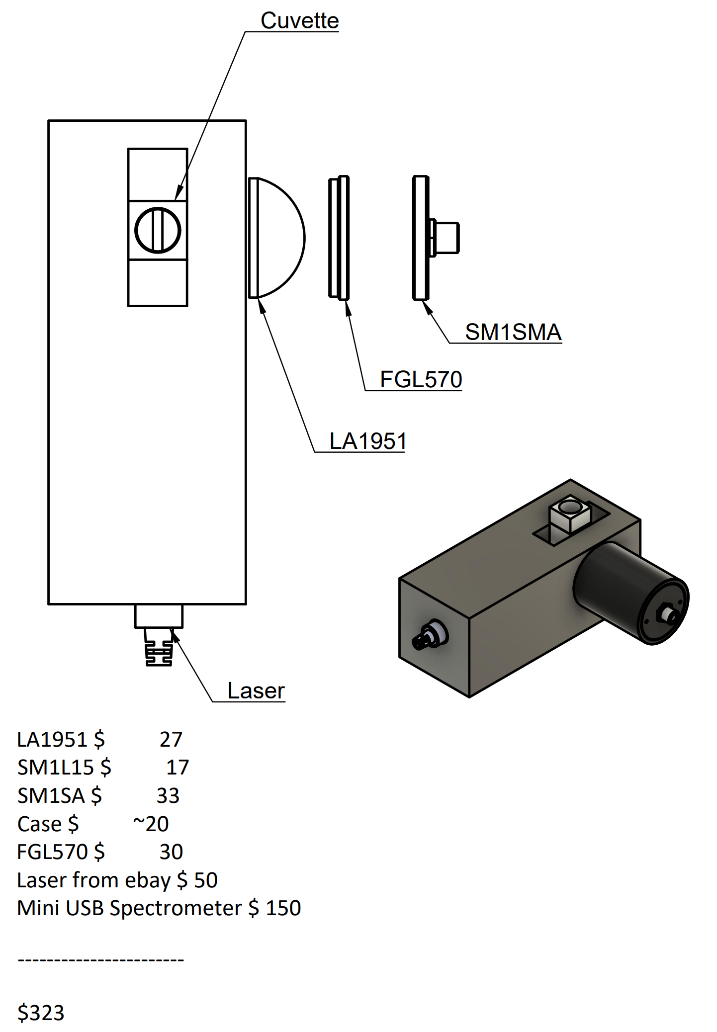

I came up with this design for what I imagine would be the cheapest possible raman design that I can think of.
These were my ideas:
  • Use a 90 degree scattering to avoid dichroic lens
  • 1" lens to get as much light as possible [potentially even a larger cuvette path length]?
  • Use plano lens to focus light even though it doesn't perform well
  • Use a Longpass Colored Glass Filters at a higher then normal Cut-on wavelength
  • Use USB Spectrometer from Thunder Optics which is very cheap (though I think this design would require a fiber spectrometer unless the usb input can be placed in the output beam path).
  • Use a random laser from ebay
Interested to hear if this design would work.

It's a question of tradeoff as always.
But here are a few things to consider:
  • non back-scattering setups require more alignments per sample. with solid it might be ok if you have a lot of subsurface scattering but with liquid it's going to be really painful. My first liquid cuvette was actually a 90° one! I quickly changed to backscattering.
  • you can work without a dichroic. Some older setups use a plane window with a dot mirror at the center. The laser reflects on the dot but then the Raman signal passes around it (the dot part is then obscured).
  • to be tested what's the actual effect of single PCX lens. I expect you'll get attenuation of some wavelengths but maybe we can live with it
  • although some people show Raman spectrometer built from ILX511, TCD1304 or equivalent sensors, they are super noisy.
  • all my previous comments about ebay lasers :) they can work but it's difficult to scale
So I think it's possible to make it much cheaper, but to be checked at which performance/robustness tradeoff.

Yeah with this design/concept the idea would be for the tradeoffs to always be in favor of cost and see how cheap you could go and still see something. Currently on the market there is not a sub-$1000 raman system.
The 90 degree would produce rays in all directions, so is it because you would have to collimate the light as shown in that presentation? The paper mentioned below also suggested backscattering for alignment reasons.
Currently the lowest cost spectrometer I could find was that $150 webcam based one which is based on a CMOS but is very low resolution and might not even have a high enough SNR to see something. Some other people have suggested using smart phone cameras. I am not sure that would work unless you had a powerful enough laser but that might be unsafe in the environments this would be used in.

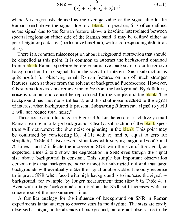

alexose wrote: Tue Mar 21, 2023 10:06 pm Something I've been wondering about: How much can software help with a noisy sensor? Could we run thousands of readings through an denoising algorithm and get a stable result?
I don't think so. This would work if the noise was predicable (think headphones that hear fan noise which has a specific pattern, the headphones can pick up on that pattern and subtract it). But dark noise is truly random so can not be dealt with in this way. I attached a page from this book:
McCreery R. L. (2000). Raman spectroscopy for chemical analysis. John Wiley & Sons.

I suppose I still don't understand why it isn't possible to average tons of spectra together. If the noise is truly random, it should be possible to increase the collection time and get a stronger SnR. The trade off would just end up being speed for clarity. There would be a point where it's not worth trying, however... nobody wants to run Raman samples overnight. (Or do they?)

You can definitely add up spectra to decrease the noise. The collection time does increase the SNR up until the saturation point of the sensor or you can average several readings together.
In Luc's software, he also adds up pixel columns whereas in in CCD spectrometers they use a lens to push the photons all into one line.
Also you can reduce noise through cooling the sensor
