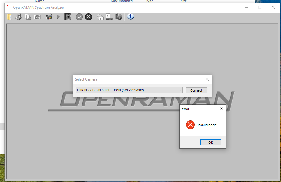

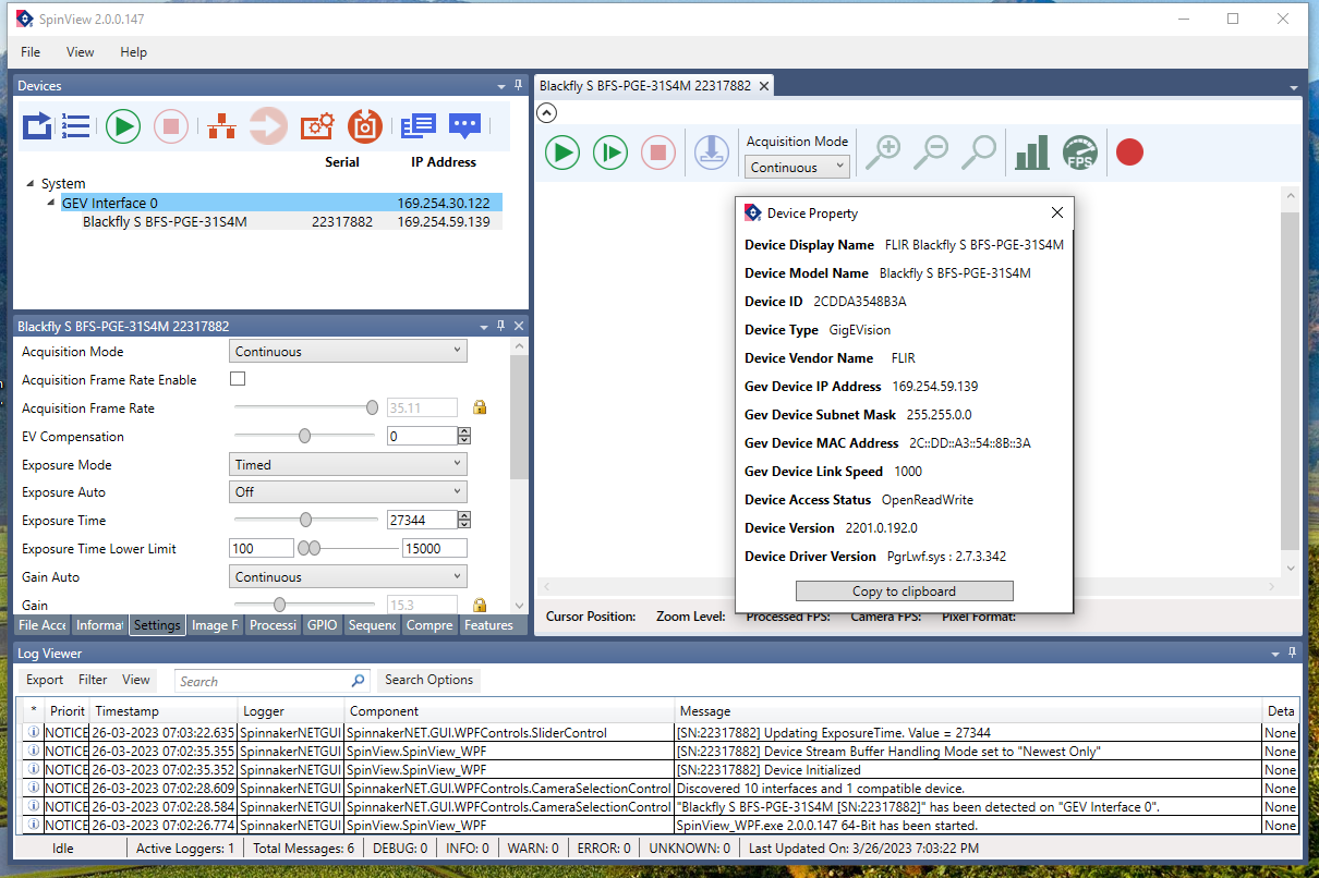

Have flir bfs-pge-31s4m camera which is recognised in Spinnacker
Spectrum analyser sees the camera but during connect have error 'Invalid node'
Also the same behaviour in successful fresh x64 Spectrum Analyser build in VS2022
Any help is appreciated

Here is the screenshot with attached zipped err file

I confirm that it is coming from a portion of the code that should never trigger (fail safe). For some reason, one of the mandatory parameter of the camera (exposure, gain, ROI...) cannot be accessed.

  • Change your adapter IP to 192.168.100.1 with subnet mask 255.255.255.0
  • Start SpinView and update camera IP; check that you can access camera frames (start acquisition)
  • Close SpinView
  • Start SpectrumAnalyzer and try if it connects
I noticed that your current IP is in the "invalid DHCP" range. I don't know if that can trigger an issue with the camera so it's better to check that first.

unfortunately it shows the same error despite IP address of the camera in correct DHCP range.
