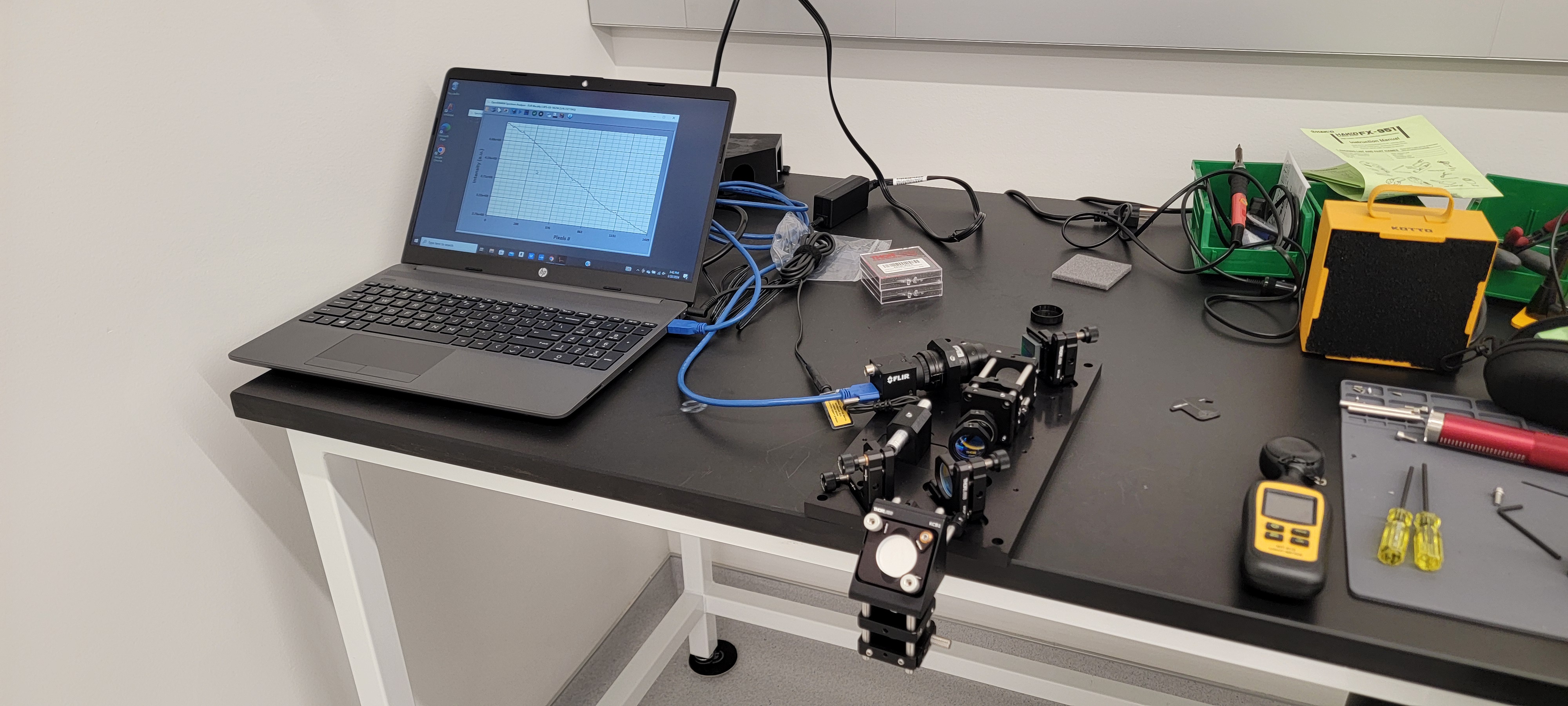

Photo attached
I used this 532nm fiber laser from civil laser which was only $1280 when I bought it (and when this is posted). I think it worked pretty well!
I measured to .9% Isopropyl but stopped there.
I did have to make several changes:
I flagged these parts as needed to be changed with new products (I can't remember if the below is the new parts or old ones double check this)
Code: Select all
CP33B  | 30 mm Cage Mounting Bracket
CRM1T/M | Cage Rotation Mount for Ø1 Optics, SM1 Threaded, M4 Tap
S30K | Ø1 Mounted Slit, 30 ± 2 µm Wide, 3 mm Long
CP14/M | SM1-Threaded 30 mm Cage Plate, 0.35" Thick, 2 Retaining Rings, M4 Tap
FLH05532-10 | Ø1/2" Laser Line Filter, CWL = 532 ± 2 nm, FWHM = 10 ± 2 nm
I used hubs.com to make the parts and Alibaba for the thread repair kits and vials.

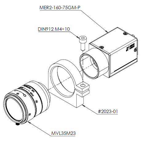

I also found the camera mount too small so I had to drill the hole bigger. I recommend changing the STEP file to make the diameter 1mm larger or so.
I have a custom STEP file with engraved labels of each part.

Interesting comment about the camera bracket. Did you check if the diameter (before drilling) matched the one in the drawing ?
I'm asking because recently I made a mod to use a NAVITAR 35 mm objective. The technical drawing mentioned something like 32.4 mm so I designed the part accordingly (it's a flange clamp) and when I got the parts (bracket & navitar lens) they did not fit! I was surprised to see that NAVITAR had changed their design and the objective was now 34.0 mm. I had to machine my bracket as well.
Changing parts are usually a nightmare in production environment (at least where I work). It would be good to find a way to keep ourselves "reactive" about that.

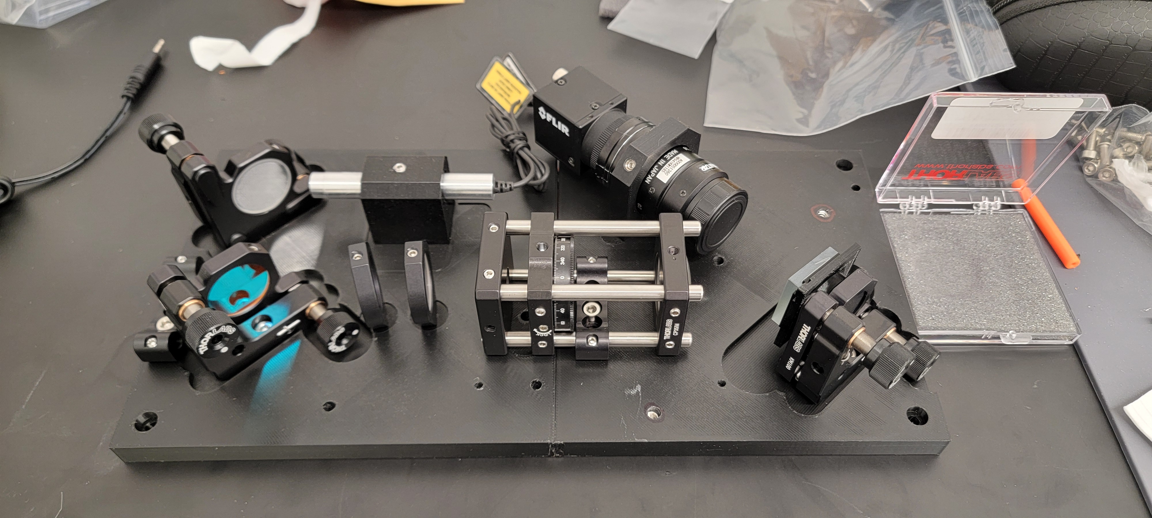

Finished my build of the starter edition!
I printed all of the 3D-printed parts myself on a Prusa MK3S+ printer with 0.4mm nozzle. The base plate, cover, laser mount, and camera mount are all PLA. The sample holder is PETG. I split the base plate into three parts and fit them together with tension pins. To minimize warping I printed the base plate parts tilted vertically on their sides rather than flat on their bottoms. All of the parts were printed with at least 50% infill and at the highest resolution setting.
I had the same issue with the inner diameter of the camera mount. Reprinted the part with diameter of 34.2mm. Not sure if that was the actual diameter of the printed part. Did not measure!
I found the alignment to be the most difficult step. It took me quite some time fiddling with the mirror and beam splitter to finally see the spectrum.
Overall a very fun build! It amazes me that I can build a working Raman spectrometer!

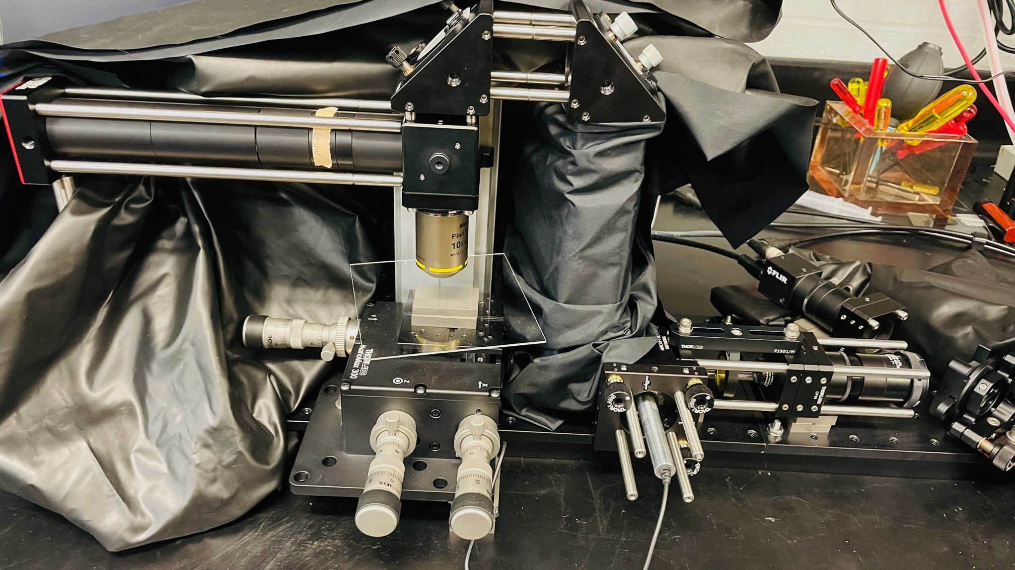

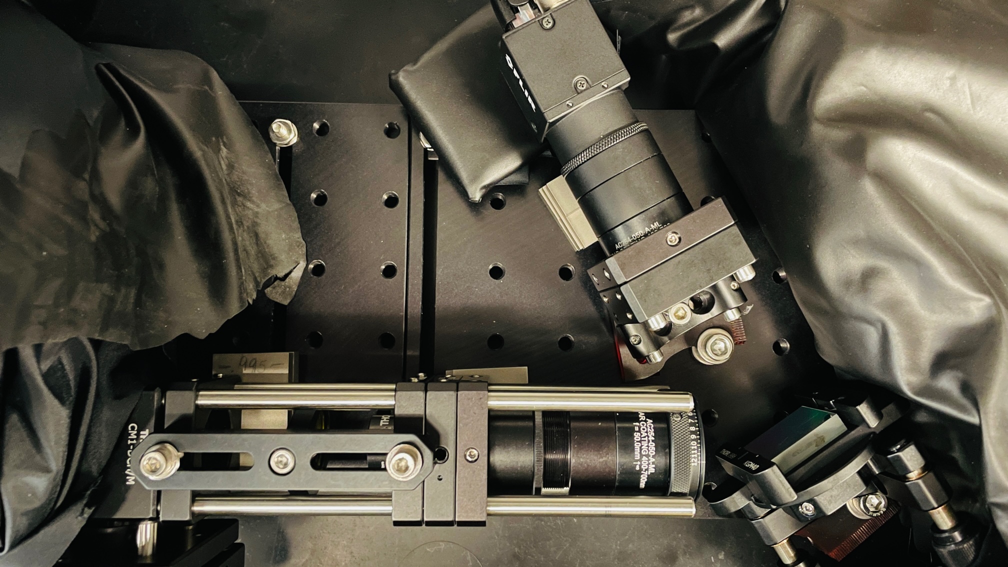

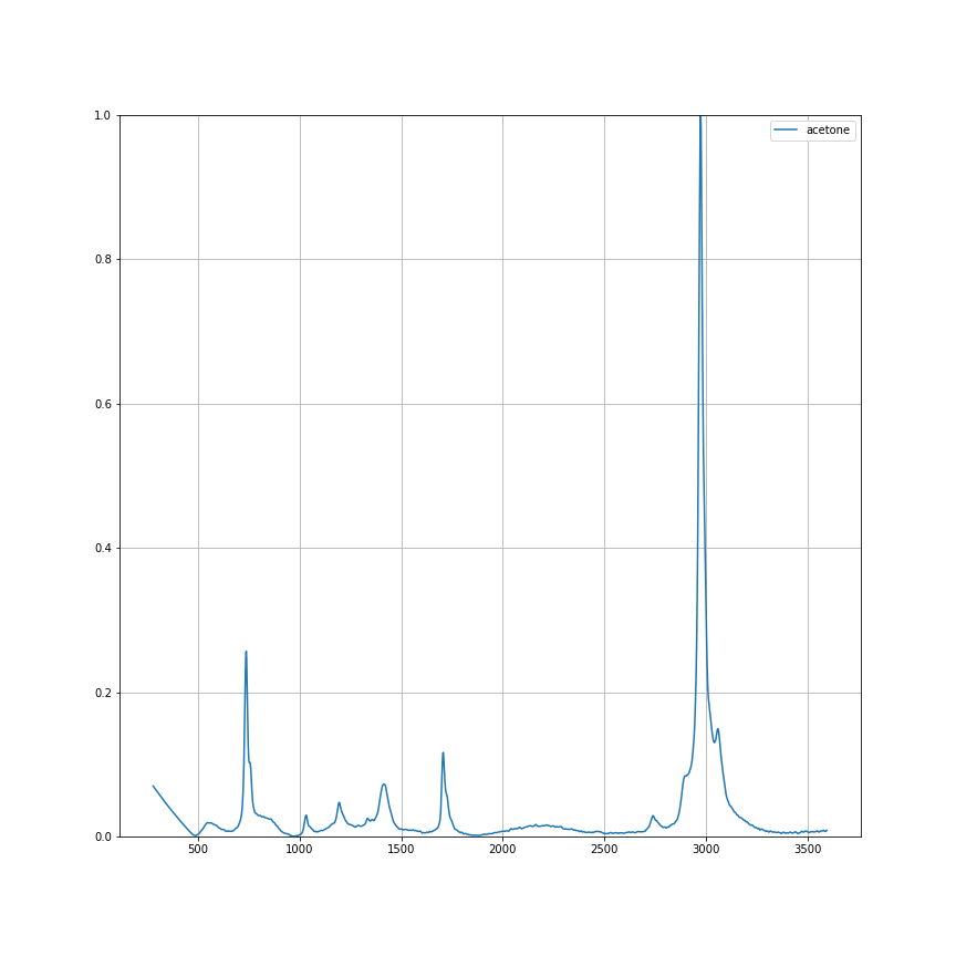

I built the breadboard version for my lab.
I had to make a few changes in order to have it work for my kind of samples. The significant modifications were:
1) Added a 40x objective in the pathway
2) Used a 3-Axes stage to hold and move the sample.
As with everyone, the alignment was the most time-consuming step. Using a Neon lamp helped a lot during the process.
I attached the spectrum for acetone (sorry for not having it for IPA).
Re: Photos of your build
Posted: Mon Apr 10, 2023 4:00 pm
by Luc
Nice mod with the second camera!
